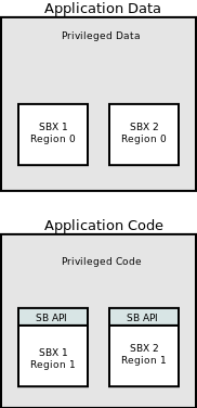

Sandboxes memory organization
Sandboxes can have two possible memory setups.
- Flash+RAM, the sandbox is linked with the main application, it uses a portion of flash and a portion of RAM, see the above figures.
- RAM only, the sandbox is “loaded” by the main application from some media or via network, code and data are in the same RAM region, this kind of sandboxes only use one MPU region.
