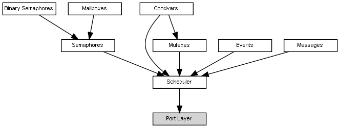

Architecture
The ChibiOS/RT kernel is internally divided in well defined modules, much care has been taken to keep the subsystems well isolated, this allows to enable or disable each subsystem from the configuration file. Disabling unused subsystems allows for strong savings in code and/or data space.
The kernel is structured as follow:
All kernel services are build around the central scheduler module. The scheduler exports a low level API that allows to build virtually any kind of synchronization primitive, other modules are built using the scheduler services and have no interactions. There are few exceptions:
- Mailboxes and Binary Semaphores are built using Counter Semaphores (note, both modules are in OSLIB, not strictly par of the RT kernel).
- Condition Variables are built to work with Mutexes in order to form Monitor constructs.
Other fundamental modules present in the kernel are the Threading module, the Virtual Timers module and the Memory Management optional modules that will be described separately in next chapters.
