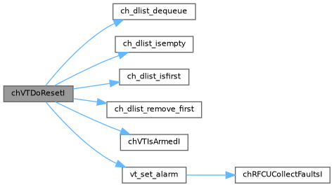

| void chVTDoResetI | ( | virtual_timer_t * | vtp | ) |
Disables a Virtual Timer.
| [in] | vtp | pointer to a virtual_timer_t structure |
Definition at line 338 of file chvt.c.
References ch_dlist_dequeue(), ch_dlist_isempty(), ch_dlist_isfirst(), ch_dlist_remove_first(), chDbgAssert, chDbgCheck, chDbgCheckClassI, chTimeDiffX, chVTGetSystemTimeX, chVTIsArmedI(), currcore, ch_delta_list::delta, ch_virtual_timer::dlist, ch_virtual_timers_list::dlist, ch_virtual_timers_list::lasttime, ch_delta_list::next, and vt_set_alarm().
Referenced by chSchGoSleepTimeoutS(), and chVTResetI().

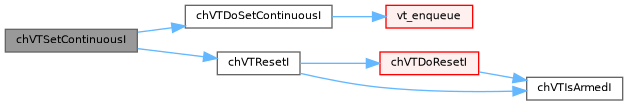

inlinestatic |
Enables a continuous virtual timer.
If the virtual timer was already enabled then it is re-enabled using the new parameters.
chVTObjectInit() or chVTDoSetI().| [in] | vtp | the virtual_timer_t structure pointer |
| [in] | delay | the number of ticks before the operation timeouts, the special values are handled as follow:
| [in] | vtfunc | the timer callback function. After invoking the callback the timer is disabled and the structure can be disposed or reused. |
| [in] | par | a parameter that will be passed to the callback function |
Definition at line 390 of file chvt.h.
References chVTDoSetContinuousI(), and chVTResetI().
Referenced by chVTSetContinuous().
